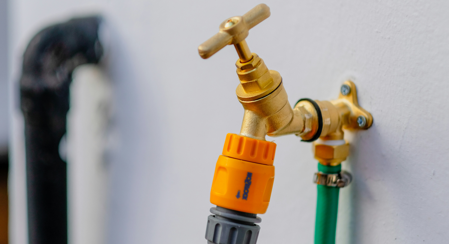

    Here is your reminder to check your exterior tap (if you have one).
    As sub-zero temperatures are now being experienced/forecast, the likelihood of potential pipe freeze becomes a possibility! Therefore it should be isolated internally to prevent any potential of the pipework freezing, and leading to interior leaks.

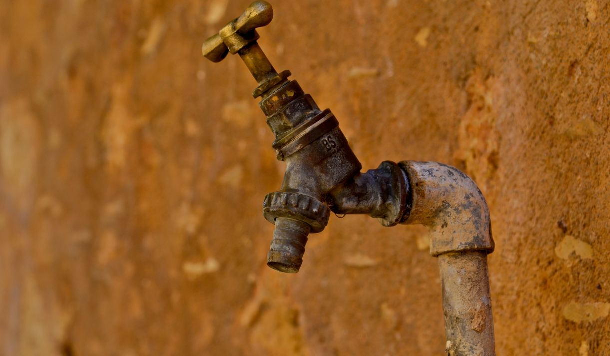

    To isolate the exterior tap (in the majority of cases where the tap itself sticks out of the brickwork and most of the pipe is behind the brick work), the isolating valve/tap is installed within the sink base unit. With this being the case in your home, you just need to switch the valve/pipe to the off position. Once isolated, go to the exterior tap and turn on to remove any water that may remain within the pipework. For the period of isolation, it's advised to leave the tap in the open position.
